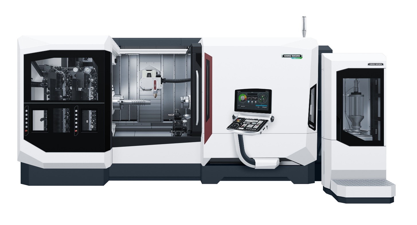

LASERTEC 3000 DED hybrid combines turn-mill and AM technology to enable conventional metal cutting and DED*1 applications on just one machine. DED describes the process of applying metal powder through the powder nozzle in parallel to laser irradiation, in order to melt the metal powder and harden it again for deposition. LASERTEC 3000 DED hybrid offers fast deposition on large-size workpieces up to φ400 mm×1,321 mm*2. The powder feeder can switch between different types of metal powder, thus allowing the deposition of multiple powders in layers on one base material. Furthermore, different types of metal powder can be already mixed before application, in order to create composite materials and realize a diverse range of depositions, repair and coating processes.
LASERTEC 3000 DED hybrid is equipped with the AM head on the turning/milling spindle for simultaneous powder supply and laser irradiation, and also adds a B-axis for 5-axis DED application. The AM head is stored away during metal cutting processes; so also conventional machining doesn’t require any setup changes and can be conducted in one chucking. Additionally, AM Assistant*3 monitors the deposition status for consistent quality and prevention of production errors, as it automatically calibrates the powder flow and detect nozzle conditions.

1. Hybrid 5-axis turn-mill and DED machine
- Process integration of 5-axis turn-mill and DED applications on a single machine
- 1 machine for turning, milling and additive manufacturing
 - Simultaneous 5-axis machining by 3 linear axes (X,Y,Z), B-axis (turning/milling spindle) and C-axis (main-/counter spindle)
 - Maximum workpiece size for deposition: φ400 mm×1,321 mm (with B-axis at 90°)
- Tilting the AM head (B-axis at 180°) also allows deposition of workpiece end faces with a maximum size of φ670 mm×932 mm
 - The most compact design in its class
- width 6,876 mm (tool storage of 38 tools), depth 4,510 mm
2. High-performance AM head
- AM head equipped on turning/milling spindle compactMASTER for simultaneous powder supply and laser irradiation
- Even with the AM head mounted the turning/milling spindle keeps a compact length of 550 mm
 - Coaxial nozzle adopted for perfect coating applications
- Laser output 3 kW
 - Different spot sizes available: 3 mm and 1.6 mm
 - The AM head can be stored away in the AM head stocker if not in use
- Prevents cutting chips and coolant from entering the optics inside the AM head during metal cutting
