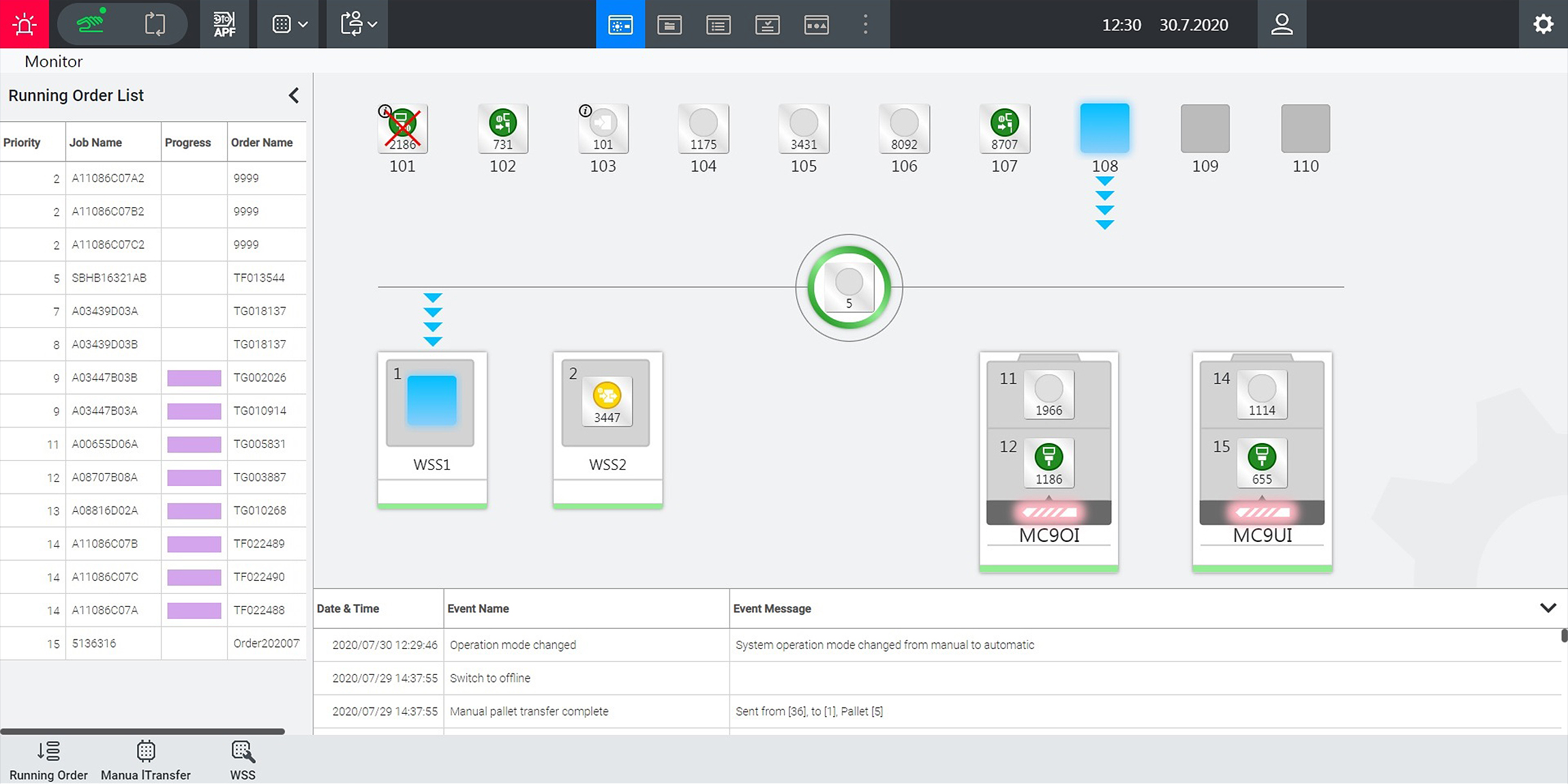

The CELL CONTROLLER LPS 4 offers a clear display of machines, setup stations and line status, incl. manual intervention options in the sequence, for example for pallet transports.

  • Management of all jobs in the entire system: single jobs / jobs with multiple stations / job families
  • Interface to CELOS Job Manager
SET-UP MANAGER
  • Creation of individual jobs
  • Access to resource database, e.g. clamping devices and tools
REPORTING
  • Detailed reporting on job and machine level / total plant / tools etc.
  • OEE evaluation
