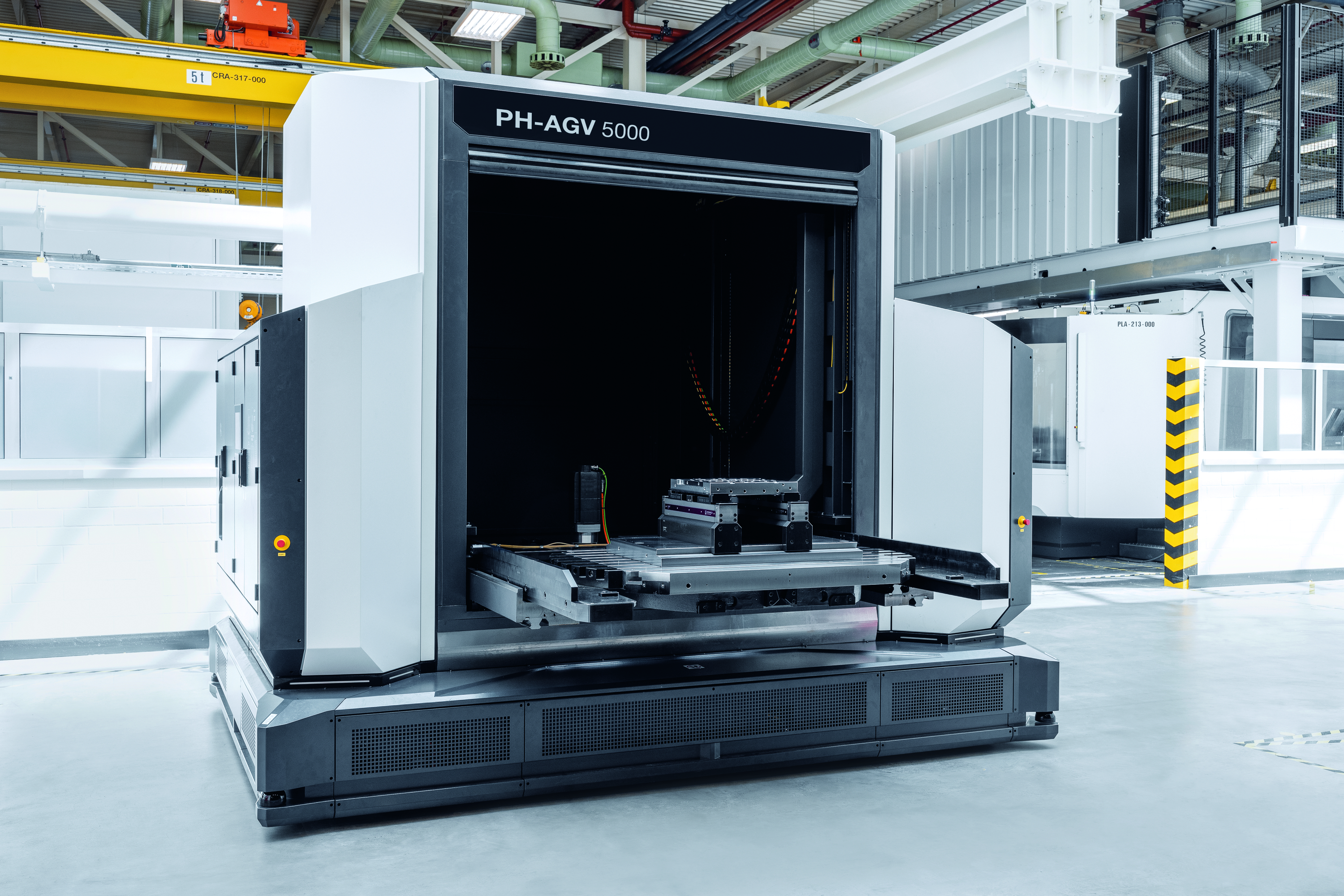

At Husky Technologies, a PH‑AGV 5000 from DMG MORI enables fully automatic loading and unloading of three DMG 160 U machining centers, which are also supplied with tools fully automatically.
These are blanks from which PET containers are formed. Husky Technologies optimized the milling of the base plates of these molds in 2020 with three DMC 160 U from DMG MORI and a fully automated tool storage system. This year, the process was further automated using a material storage system for 422 components and a PH‑AGV 5000, a self-propelled transport system that autonomously loads the machines.

In the next step, Husky Technologies plans to install additional pallet storage racks so that the PH‑AGV can operate autonomously for several hours. The driverless transport system moves components weighing up to 4,000 kg from a remote storage facility to the machine and loads them directly onto the pallet changer. To supply material to the three DMC 160 U machines, Husky Technologies has installed a linear storage rack with space for 422 components. “Depending on the current job, the required component is automatically brought to the loading terminal,” says Laurent Huberty, describing the process. The plate must first be clamped into the PH‑AGV 5000's loading station, he says. “From there, the driverless transport system independently picks up the prepared pallet and takes it to one of the three machining centers.” On the way back, the PH‑AGV 5000 brings back a previously finished plate if necessary, he adds. “Loading and unloading is completely automatic, allowing us to shift labor capacities for more qualified tasks in tool preparation or programming.”
PH‑AGV 5000: Safe transport through the production environment
The most important aspect for Husky Technologies when operating the automated guided vehicle system is safety. As the PH‑AGV 5000 moves through the normal production environment, it will also have to interact with people walking by. The AGV can achieve a speed of up to 9 km/h. “Safety is provided by a laser that scans the environment in the direction of travel. If an obstacle is nearby, travel is slowed down or stopped in time if necessary.”
