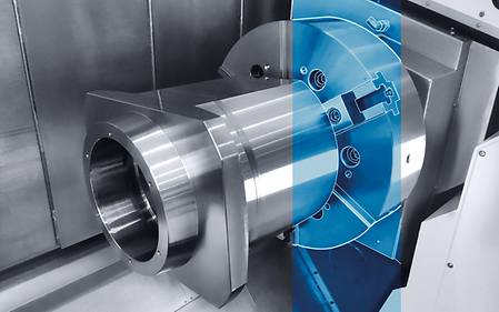

autoCHUCK 2.0
  • Automatic optimization of servo drives parameters for Main- and Sub-Spindle
  • Reduction of Setup time
  • Optimization of machining result
Customer Benefits
  • Setup Time reduction
  • Automatic determination of parameters independent from machine operator experience
  • saving the setting in NC-program for more quality assurancet
User Interface
Left: Simplified usability of measuring and parameter setting procedure / Right: Local saving of parameter in NC-program
